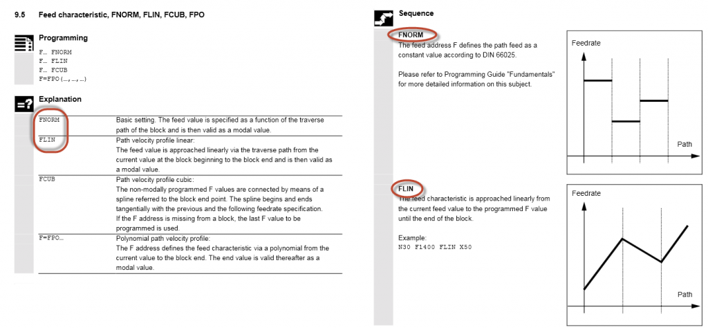

Sinumerik FLIN & FNORM?
I was told sometime ago that Sinumerik FLIN & FNORM functions are not emulated by VERICUT...
However, I know CGTech put significant efforts in Siemens functions in the past 2/3 years... who knows they're available now...
These two functions are critical to turn milling operations as they have a huge impact on feedrate calculation and thus in the total cycle time calculation... Currently, our time estimates in VERICUT for operations using FLIN are totally wrong and unreliable...
Does anybody know if these functions are available now? If not available, are there SPRs requesting this already?

Re: Sinumerik FLIN & FNORM?
Now possible in 7.3
I knew they would make it someday, but I admit I wasn't expecting it so soon.  tongue
Thanks again CGTech!
