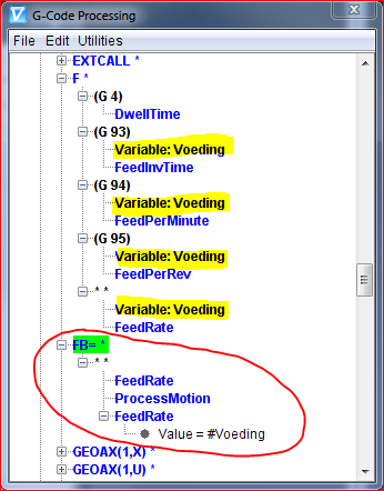

Does anybody know which macro I can use to implement Sinumerik FB (Non-modal feedrate)?

That's not to difficult.
First you need to store your regular feedrate (F)
On the line containing FB= you need to set the new feedrate, process the motion, and restore the saved feedrate.
Configuration > Word Format > Add word FB= with the same characteristics as word F
Configuration > G Code processing > Registers > F > Add for all feedrate macros a variable.
Add new register FB= with macros:
- FeedRate
- ProcessMotion
- Feedrate > Override value = #variable
When you run a simulation you will not see a feed change in the status window because, at the end of the FB= line, the regular feedrate has been restored.
Easiast way to check if things work is to write a couple of lines (or MDI) with a long motion with low regular feedrate and in the next line make the reverse motion with FB= half the regular feedrate.
Check the Time in status to see that the FB feedrate was effective because it uses double time.

An alternative configuration can be:
[attachment=0:1r30ysqm]<!-- ia0 -->FB.png<!-- ia0 -->[/attachment:1r30ysqm]
