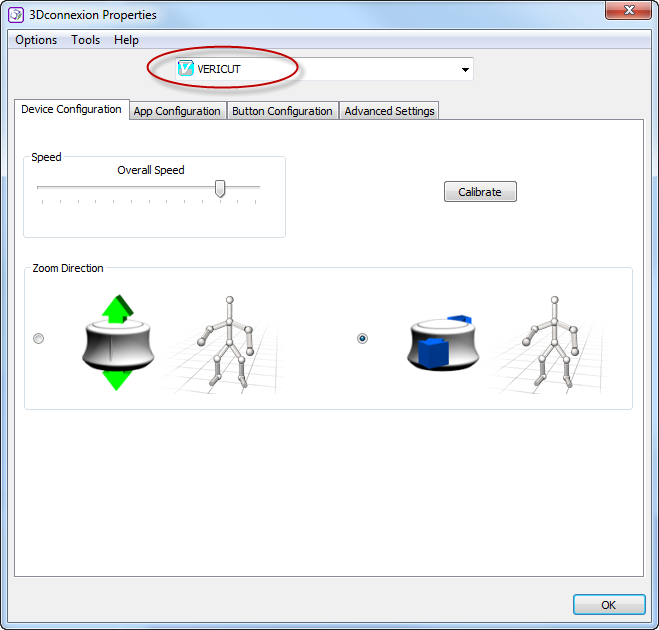

I just finished the configuration of our SpaceMouse Pro 3D mouses and I'd like to share what I learned:
3D Connexion supplies a profile (*.scg) file for VERICUT. In a x64 install, it's usually installed at:
C:\Program Files\3Dconnexion\3Dconnexion 3DxSoftware\3DxWare64\en_us\profiles\default\VERICUT.scg
This file contains the information about how VERICUT interacts with the mouse (Some stuff is also hardcoded inside VERICUT so that's why it works for you even without this profile - But VERICUT internals don't take advantage of any button)
The thing is that this .scg supplied by 3DConnexion is misconfigured for VERICUT:
If you open yours, you are going to see that the value in the "EXECUTABLES" parameter is "VERICUT.EXE" - There's no VERICUT.EXE - VERICUT it's a Java App and it runs under the JVM (Javaw.exe)
So in the task manager, what you see is always "Javaw.exe"
That being said, you have to change the VERICUT.scg file to work with "javaw.exe", like this:

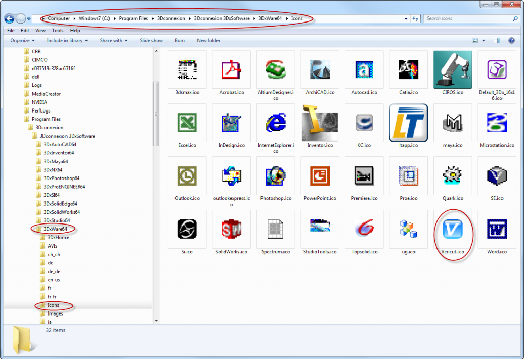

Notice I also changed the default icon - You have to put your icons usually (x64) at C:\Program Files\3Dconnexion\3Dconnexion 3DxSoftware\3DxWare64\Icons
This way VERICUT icon will appear in the 3DxWare profile settings...

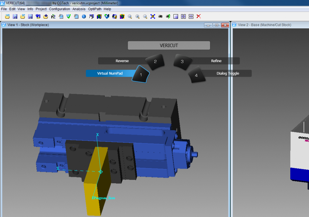

This profile will give you some extra buttons working for VERICUT:
Fit
Refine
Reverse
As the profile supplied by 3DConnexion does not reference "javaw.exe", the customizations done by CGTech/3DConnexion are not used. A user profile is then created in the %AppData%\Roaming\3Dconnexion\3DxWare\profiles\ - But this profile does not use any of the mouse buttons... just the joystick...
With the profile in the .zip file above, you should get some extra functions of your 3DConnexion device.
